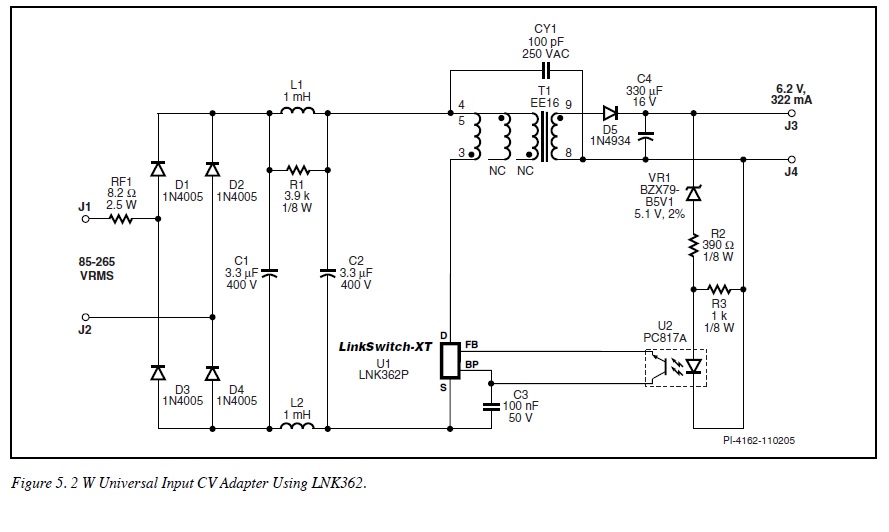

Nobody who really knows the answer?
I gently tried cutting the connection between C39 and the bridge between R119 and R118, but since they are still connected, maybe they really are supposed to be connected. I like to know.
le 09/03/2017 à 21:00
Okay, I assume CONNECTED.
I think exploded solder would be easier to clean away than a real path. Also Google image search for 136005602 gives 2 images hosted on alexey-bass.blogspot which have a unclear view of a green path running to C39 too.
le 09/03/2017 à 21:39
Hello guy. i'vejust seen your request.
I just look at pictures taken in 2015 and I confirm that one of the C39 connections is connected between R118 and R119. For the other connection of C39 I dont know, but I think there is no problem on this one.The drawing that I made is incomplete, it is a partial diagram representing the two resistance chains, that is why the connection of C39 is not represented.

Bad news. Diode bridge D19 seems to be blown. Maybe more damage in other components of the machine because a loud 'boom' was reported.
Diode bridge D19 is 1000V 1A?
le 20/03/2017 à 21:14
The Diode bridge D19 is a GBU407 1000V 4A (peak 150A during 8.3 ms).
It is possible that there is that the diode bridge which was damaged. Check that C19 is not in shortcut.
See below the block diagram of the power coming from the datasheet of the LNK 364 and a part of the datasheet of the GBU407
